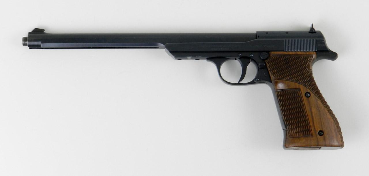

#10 ·
It shot as well as I could hold the long skinny barrel and bead sight.
Unfortunately I long ago foolishly sold and traded it and several other uncommon .22s in a search for something different. I wish I hadn't.
It looked like this one except not threaded at the muzzle.

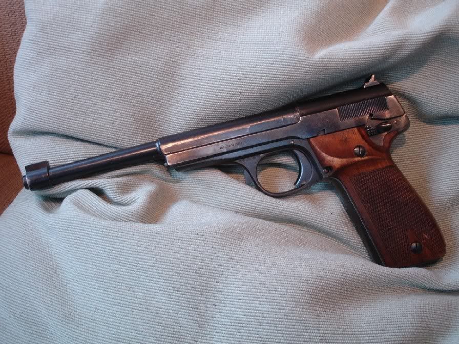

#14 ·
Speaking of Walther Olympic pistols, this is the 1936 model. It still works but the front sight flew off during an outing about ten years ago.
That's really cool. I found a schematic for it and it looks like the front sight is just a simple piece of steel that is pinned in place. It seems like it wouldn't be hard for a gunsmith the fabricate and replace.
