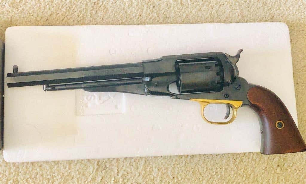

A local shop had an older Pietta 1858 Remington that has been sitting on the shelf for a while. I made an offer of $200 and they accepted so she is mine now.
Definitely a fixer-upper. The nipples have corroded and there was rust in the cylinder threads; and the wood needs some work but the overall finish, chambers, and barrel are in good shape.
I have some Slixx Shot stainless steel nipples on the way. That’s should get her running right, and they run perfectly with Remington #10 caps which I have a thousand plus of home. I spent an hour getting cleaning her up last night, but I think she’s gonna be a solid shooter. Those nipples took my 1851 from about 60% reliability to 99%. I rarely have a misfire or cap jam with that gun now.
I’ve been saying I was bored and needed something new to tinker with, well here she is. She looks great next to my Uberti 1851 Navy. I picked up some .454 balls and some fresh Goex while I was there.
No manual came with it. I’m assuming 30-35g grains of FFFg should be about right. I run 20-25 in my .36 1851 Colt. Hopefully a .454 ball will shave a good lead ring.
Unfortunately I am a lousy photographer but here is a quick pic:
Should be a lot of fun to tinker with this spring and get her running right. I’m curious what kind of accuracy I will get with her. My 1851 is impressively accurate even by modern standards.
I may try some conicals later after I do a little research. I’m not sure conicals will fit without modifying the cutout in front of the loading lever.

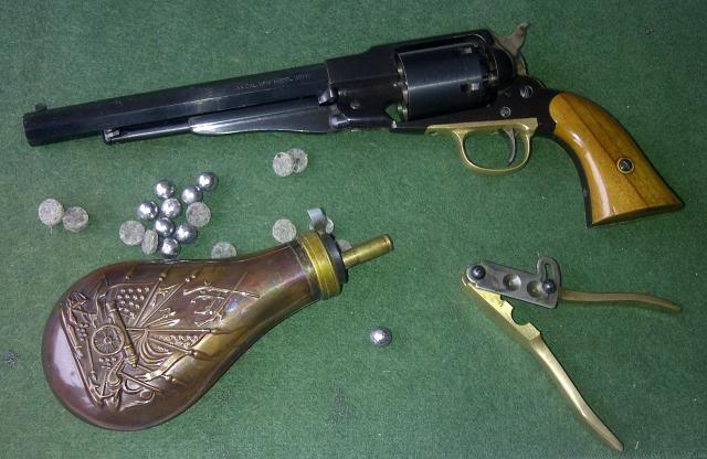

I have 9 Ruger Old Army cap-and-ball percussion revolvers (mix of blued and stainless, adjustable and fixed sights), as well as a dozen originals I fire regularly with light loads...
here is my kitty with some of my stainless ROAs:
here are some of my original vintage Colt revolvers:
here is my original 1837 Allen & Thurber Pepperbox in .31 caliber, which I fire with 15 grains of FFFg:
here is my original Hopkins & Allen 3rd Model Bacon .31 Pocket Model:
I actually do not have a good photo at the moment of my original Remington New Model Army .44 caliber (1863 vintage, based on its serial number)
here is video of me firing my original Colt 1860 Army recently, again with 15 grains of FFFg and lubed WonderWad under a 0.454" diameter lead round ball...
