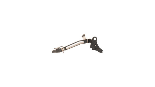

I went with this one for my Dagger;
While in there I also installed a Glock "-" connector and did a $0.25 trigger job.
