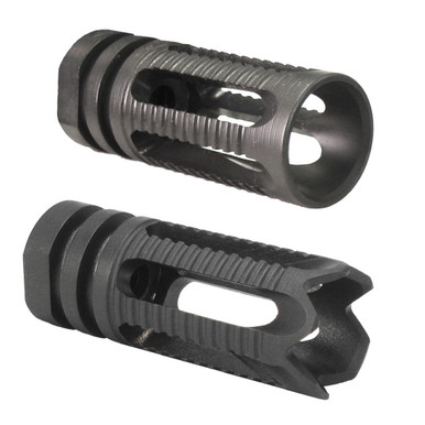

#6 ·
I have the smooth version of this flash hider installed on my rifle. Seems to do a slightly better job hiding flash than an A2 birdcage.

#24 ·
I recently had a 4 prong flash hider pinned to a Colt 6921 upper.
I am very pleased. Very little 'ping' from it.
