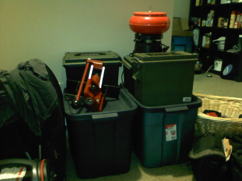

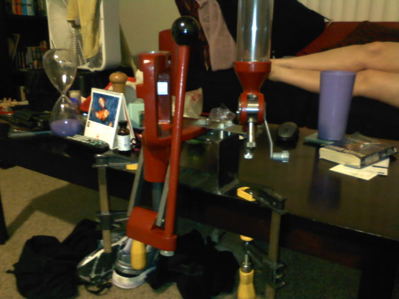

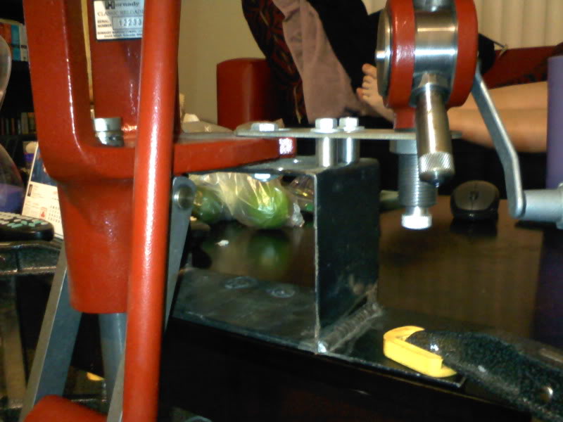

My reloading setup was totally mobile until recently.
I made a base for my press from some scrap metal. Its basically a 4" high, 4" deep rectangle about 6" - 8" long. Has a flat base across the entire bottom that extends 4 ush inches past the rectangle. Press is bolted to the base. The base got clamped to whatever free counter i had.
Will try and find pics.
