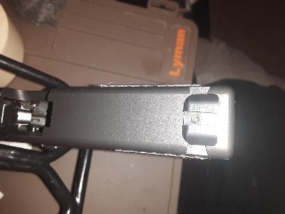

Several months ago I had installed sights for the first time. Had placed skateboard tape on top and sides to aid in sling-shotting. I should have removed it first. Anyway, with that tape still on top I came down too far using the sight pusher. It actually got stuck there. Had to move it and it was very tight. I could not relieve the downward pressure at all and was finally able to move laterally. I anticipated damage to the pusher as well as the slide's finish.
Result- Top of slide under the tape appeared marred with scratches. The installation was otherwise successful and the pusher was not damaged.
But the marring, scratches, and what appeared to be removal of finish in front of the rear NS lingered, and that was upsetting to me in spite of the fact that I had covered it again with skateboard tape.
It bugged me because the rest of the gun had remained pristine. And I'm not even thinking that I might sell it. I shoot three calibers out of it and do not foresee a sale in the future.
Please refrain from the 'group-think' comments that it's 'just a tool' and those other garbage type of comments. blah blah blah. Those comments are not relevant and are annoying. Some people care about the finish of their guns and some don't give a hoot. I fall into the former category. Respect me for it and don't waste anyone's time here. I respect that you may not give a hoot. Good for you, not for me (and others)!
What worked well for me:
1. degrease
2. #0000 steel wool w/
3. CLP
All signs of the marring/scratching were eliminated. I'm quite happy about it. Only have an 'after' photo. Sorry about that, but trust that it worked for me! And with the benefit of hindsight, what occurred might have been worse had the skateboard tape not been on top.
Addendum: I also noticed a faint, ugly vertical scratch on the slide's right side that seemed embedded. Swiped #0000 with CLP in one direction only using slightly moderate pressure. After doing so multiple times, the scratch is now gone.
According to what I've read, my Glock is in better cosmetic condition than many BNIB.

Now for the real test; degrease your slide complety bone dry and rephotograph it.
The "P" for "protection" in "CLP" products is a surface treatment that remains after the solvent (the "C" as in "clean" part of "CLP") part of the formula evaporates. This compound fills in minor scratches, fine striations, and porous areas of the metal surface(s), adhering well to every surface that it's applied to (else it wouldn't work so well), making these scratches seem to disappear and blend in with the surrounding area, but they're still there, 'just not as readily observable due to the glossy nature of the protectant.
There's also a good chance that the scratches weren't scratches into the slide at all, but was simply carry over material from the tape/sight pusher that was removed from the surface with the 0000 steel wool, similar to the way that brass "kiss marks" on rifle receivers are only marks on the surface of the material that can be removed without harming the finish below them.
Since we have no clear images of before or after, it's a little tough for me to see...

I agree completely with those who suggest that there was only a mar or deposit of material onto the surface of that "fry pan" finish. Definitely there was no scratch that removed any finish. I've had the same persistent marring occur on FP-finish Glock slides that vanished entirely after a great deal of rubbing with a cloth. I also used Break Free-CLP as solvent..a wonderful product for many purposes.
OP...your results removing the marring deposit look good. However, I would never use stedl wool on any type of Glock finish unless I wanted to do what a real scratch would have done...remove the finish. You were lucky that did not produce unintended and unwelcome results.

The clean-up treatment removed foreign material.
According to the OP's pics, this is what happened. You're not removing a scratch until you've removed enough material around the scratch for the scratch to be gone. This is called 'feathering' and the finish has to be touched up or completely re-done. I agree, though, that the finish is pretty tough to be able to steel wool it to remove a mark and it not show any visible side effects.
