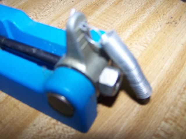

#7 ·
That is basically what I did, except I drilled a hole near the top of the thumb lever and installed a cotter key. Then from HF spring kit attached it to the HF cotter key back to a L screw hook. Instead of grabbing the thumb lever, just place the case on the shaft and press down on the case and shaft. Swag and automatic eject.
