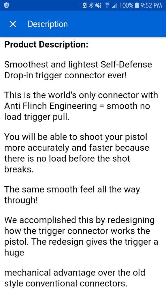

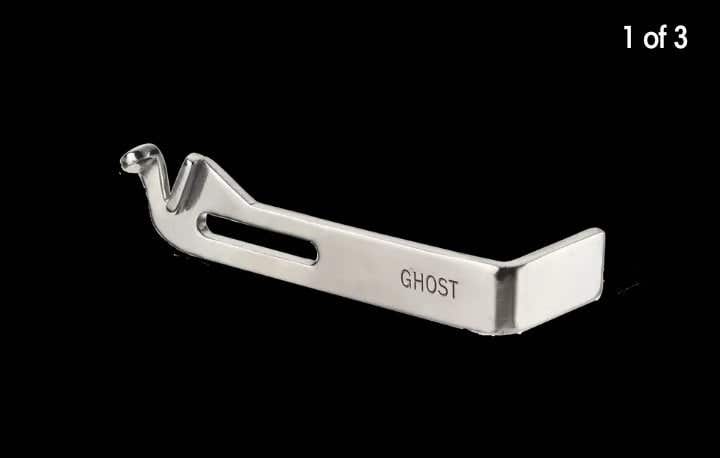

It caught my eye because it looks completely different. But does it work like they claim?

I put the Angel 3.0lb connector in my Glock 23 gen 3. I did have issues. When shooting, the first round would fire. Upon a very short reset, the next round would fire. Then after that, I would have a dead trigger. The slide would have to be racked to reset the trigger. So it worked for two shots, then dead...everyone. I just put my Ghost Edge 3.5lb connector back in and there were no issues.
Anyone else notice the geometry at the top of this connector is backwards relative to standard (and non-OEM copy) connectors? I'm curious why / what that's got to do with how this one works differently.
Shortens the distance that the slide needs to travel to reset the trigger.
But what's the point of that? After my first response, I realized this was a resurrection of a several years old thread, and this isn't exactly a new product...but in Googling, I found multiple reviewers saying it caused various sorts of malfunctions. Seems like this connector is a solution that only causes additional problems.
