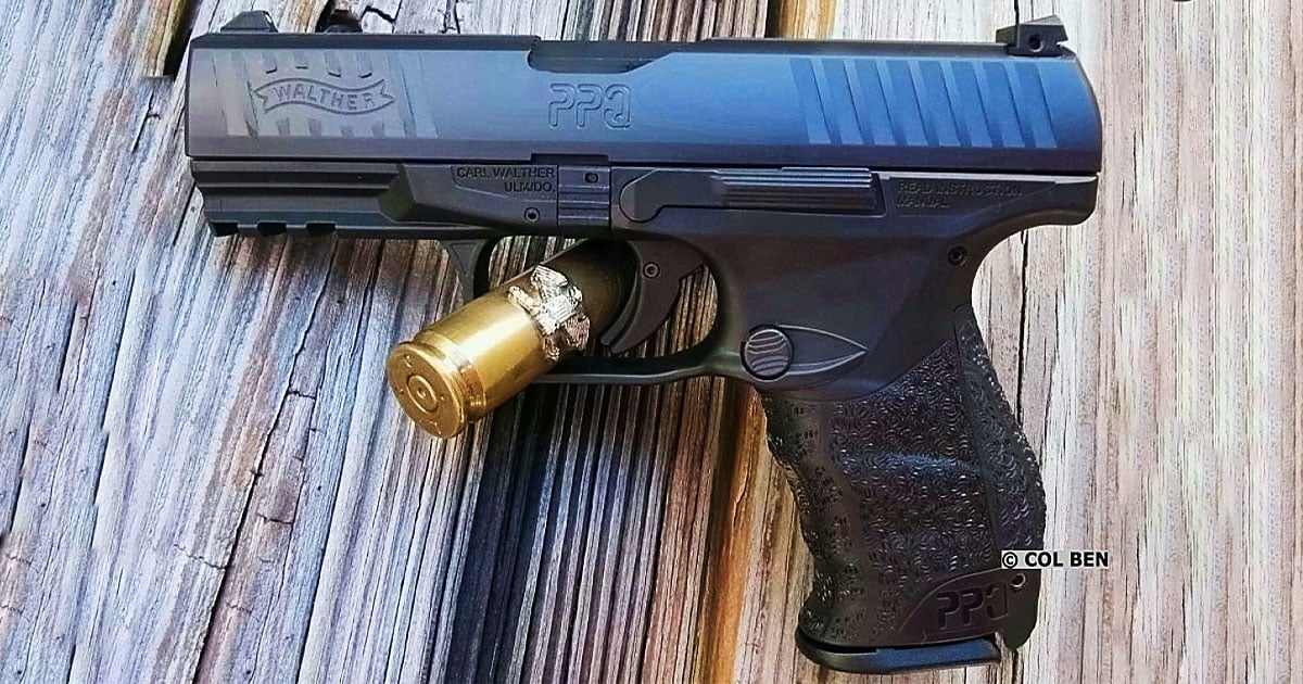

Just found out Walther has replaced the PPQ with the PDP. What was the reason? How does the PDP compare?

Grip texture better and more wrapped around.
Slide is HUGE on the PDP. Anti glare channels deleted on the PDP. No more paddle release M1 so far.
Some say the trigger is different, but I can’t see it. I have a SF Q5, a Polymer Q5 and a PPQ. All have the same trigger. I really disagree that there is a felt difference in the PDP, which some say is a more defined wall. There is zero creep in my three PPQs at the wall, so I don’t know how there can be a more defined wall with less creep.
Glock sights fit the PDP.
There is almost zero "rounding" on the PDP.
While huge, the PDP slide weights the same.
I think the PPQ slide is superior. The PDP is probably the largest slide today. It's really disappointing.
I think the PDP is a disappointing change.
