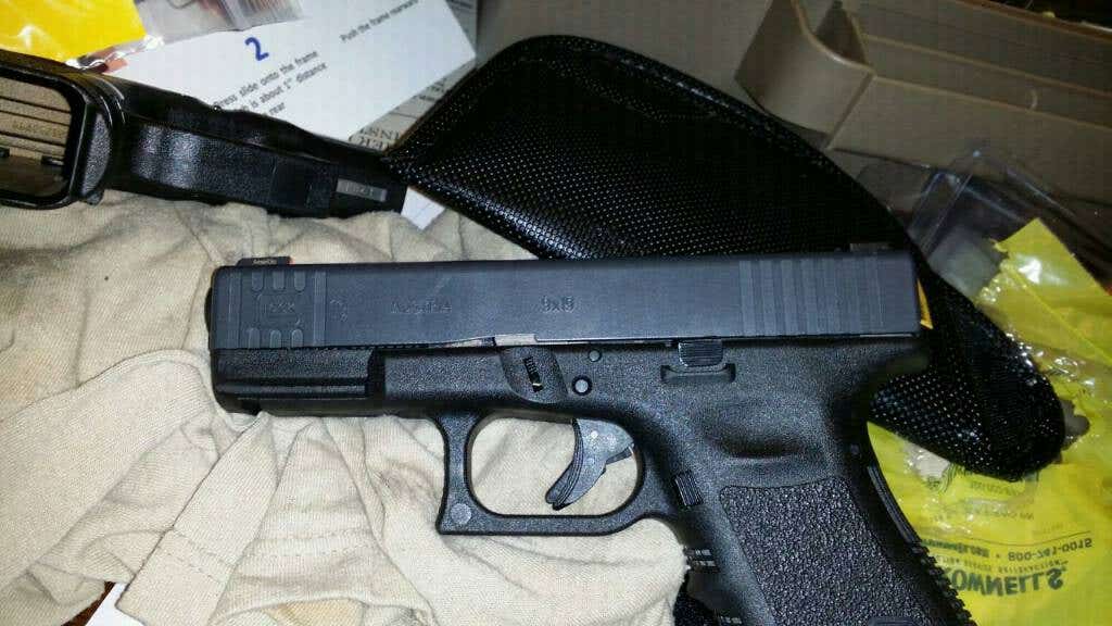

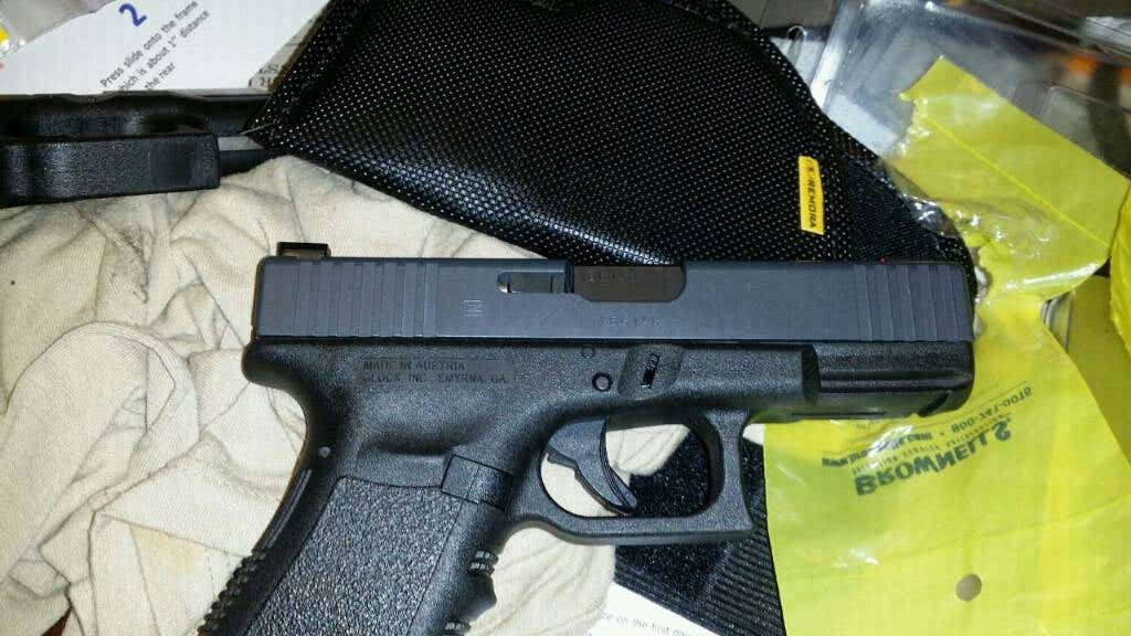

And here is the gun. No I'm not asking for your opinion on whether serrations are good or not, nor am I asking if you like the color (ghost gray). Please don't give your "glock talk" snarky, responses.
