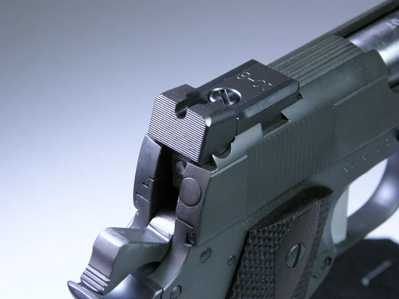

One other thing that I'd like to toss out there and get your thoughts on. What about an adjustable sight? I've seen pics, as I'm sure you have too, of 1911's hat have these great adjustable rear sights on them that are set deep into the slide and they look like they almost grew there, they just look really classy. I know I'm not using the words to describe what I am seeing in my minds eye, but I hope you get the point.
Kinda like this on a Premier II from Baer.....
Another kinda like what I am asking about....
Basically the kind of rear adjustables that are "melted" into the slide.
Just tossing that idea out to see what you all think of the idea.

The cut in Bomar was all the rage back in the day. However, I lot of guys I shoot with today opt for fixed sights. Anyone who has shot enough has had a Bomar clone come apart on them. My genuine BoMars seem to have held up OK though.

If you opt for adjustables, they will sit oddly rearward if the gun is a series 80.
You could have a Novak cut and have a Novak carry sight installed.
You could find them in adjustables too, but they would not look like the Bomar.
If you have the slide cut for a low mount Bomar type sight. You can now get a night sight adjustable. You can also get the fixed as you have pictured that fits those types of cuts. They are more for people that have their guns already cut for a Bomar type sight, but don't like adjustables.

I have the 10-8 U sight with a 24K Gold Bead on my Colt Series 70. Of course you can use any ball sight on front like FO, Tritium, Gold Bead, etc.
Nothing wrong with adjustables, but you will find you never adjust them beyond sight - in.
I would advocate sending your slide to Tooltech/Trijicon and having their Night sight package installed. DO NOT get "ski-jump" Novak style - you need a square edge on the rear sight so you can use it to cycle the gun one handed, if one arm is injured or busy.

As has been mentioned, the Bomar style adjustable sights will slightly overhang the rear due to the firing pin safety. I am OK with the look on my Gold Cup, but that is about it for me.
That last photo you have is from Harrison Custom.
I agree it looks good. They are used to replace adjustable sights on several different guns.
https://shop.harrisoncustom.com/rear-sights
