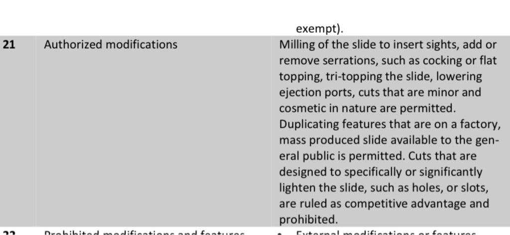

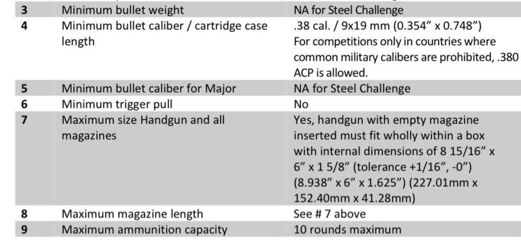

-Max weight: 45oz with empty mag

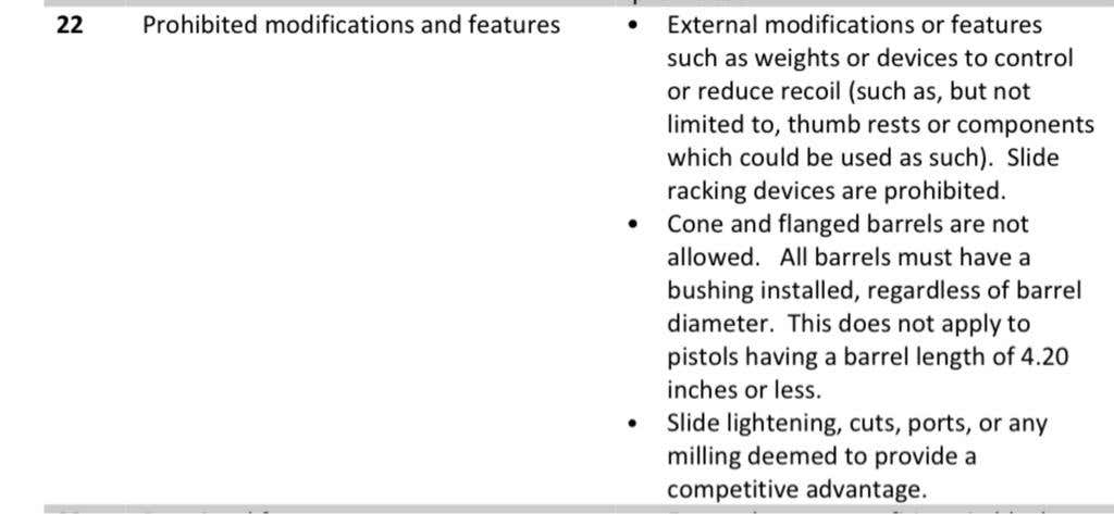

-Must have traditional barrel bushing; cone and flange barrels aren’t allowed
-Cannot have ports or slide cuts that reduce weight
-No compensators
-Must be 9mm
-Should be full size, but no extended slides because it has to fit in the USPSA box
-Maximum of 10 round capacity, no double stacks
