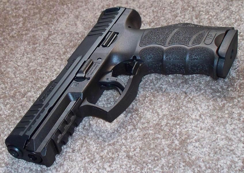

Ill now post some pictures of different aspects and angles of each gun back to back for a quick visual comparison.
