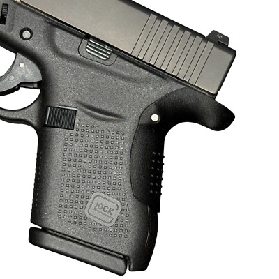

#7 ·
Thank you very much for your feedback, I must say I'm surprised it cracked, that's the first time I've seen that happen. That being said I have a lifetime warranty on these and will be sending you a replacement promptly for no charge. While I didn't have issues with that material, I did just do a material change across all of my backstraps that I've found has better strength qualities as well as a near identical frame color and texture to OEM Glock frames (shown in picture below). I did durability testing with this material on my 43x/48 version and posted the results here. I'm very glad you're enjoying the backstrap and I greatly appreciate you putting together such an in depth overview!

#14 ·
I installed the new backstraps on my G43 and G48 MOS today. Removal of the original strap was not difficult. I was expecting it to be difficult because of the 3M double sided tape. I was able to pry it off with minimal effort.
The new G43 backstrap has a grippier texture. It feels really good when gripping the gun.
The G48 backstrap is the short version. They have a longer one. I just liked the way it appeared to basically fill in the back of grip so there’s no longer a hump.

#16 ·
Looking good! Hopefully your experience in removing the backstrap is enough strength to hold it on reliably but easy enough to take it off when needed. I did testing on this and it took 23.5 lbs of force to remove, test results found here. For the strongest bond possible I would recommend cleaning the surface of the frame with rubbing alcohol to remove any oils before adhering the backstrap on. Your observation of removing the hump is right on point! This changes the grip angle from 22° to 18°, which matches a 1911 grip angle, this theoretically improves how you point and trigger alignment . This is a very interesting article on the importance of trigger alignment and grip angle. Again thank you for the detailed writeup and I'm looking forward to hearing how your range time goes!
