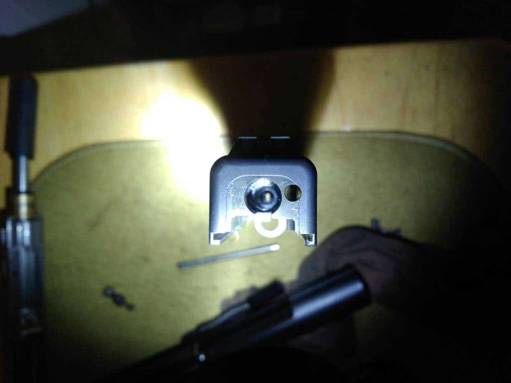

Hello, first post here, but I am not at all new to Glocks. I wanted to post my issue here first in hopes that I can A) resolve the issue without having to send my pistol to Georgia, and B) possibly help someone else who is having the same issue.

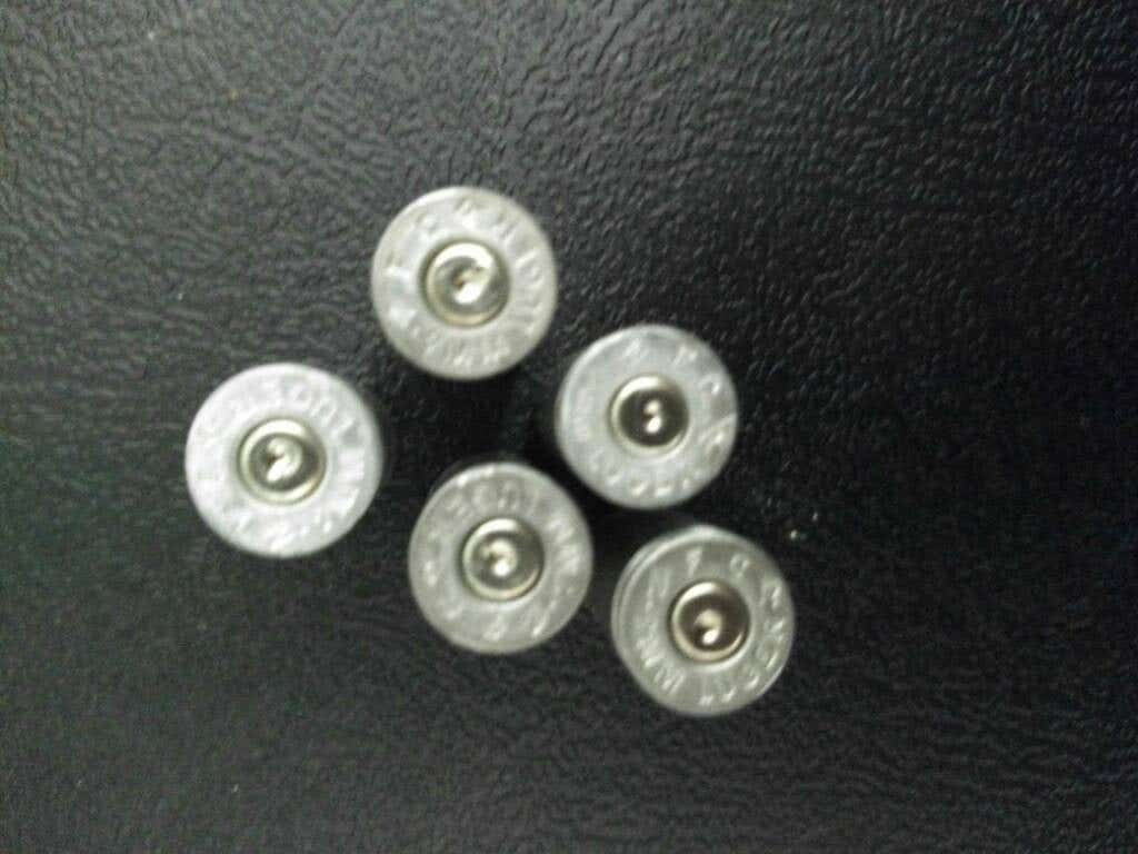

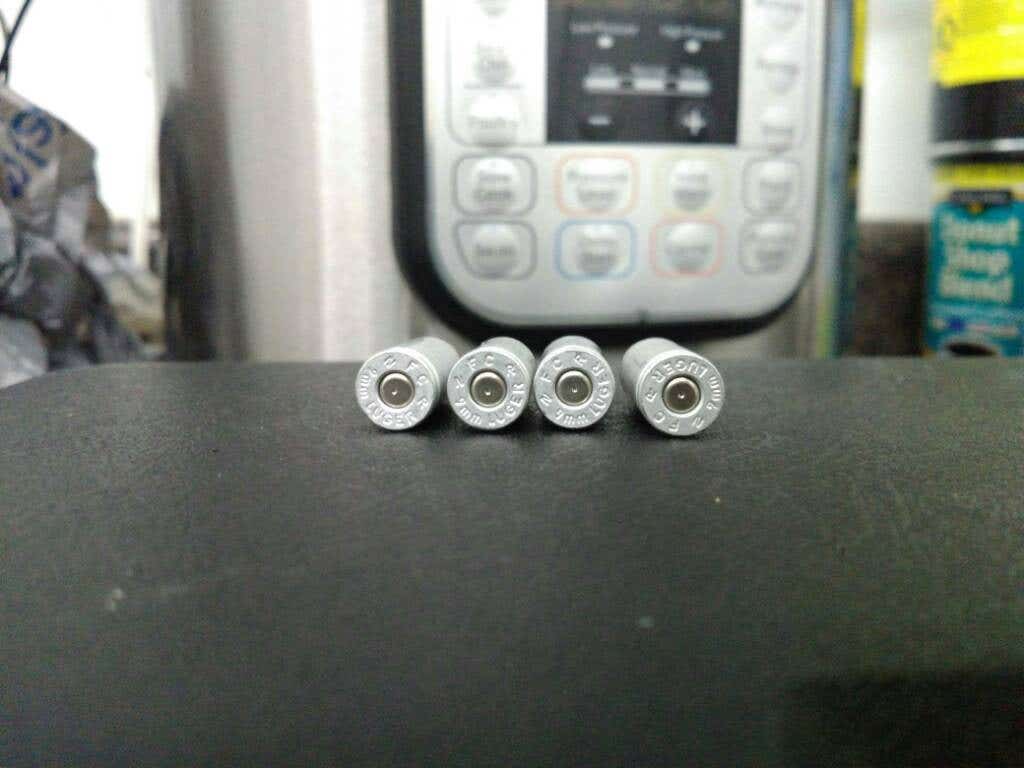

Since buying this G19 used, I've periodically experienced light primer strikes. At first, the malfunctions were sporadic, probably once every 100 rounds. I attributed this to A) the subpar training ammo I use, and B) break in time. The issue has never really resolved itself, and todays range visit produced one light strike in almost every magazine I fired. Out of roughly 75 rounds I had 5 light strikes. Ammo used was Federal aluminum 115 grain.
As this is my main carry gun, this is a pretty serious issue. Until this problem is rectified I simply won't risk carrying it. Any insight, help, or suggestions would be greatly appreciated. Below I've attached all pertinent photos, but if you'd like more please don't hesitate to ask.

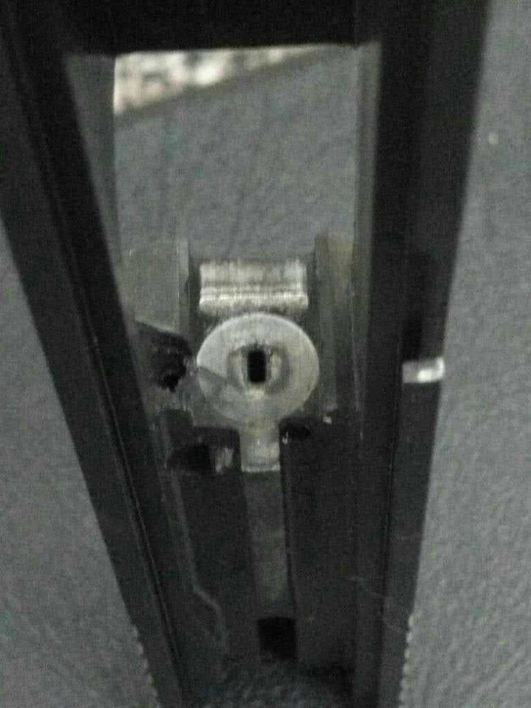

Edit 1: there appears to be a small amount of build up in the striker channel, but nothing extreme. Perhaps that's enough to keep the gun out of battery?

I don't see evidence of out-of-battery issues as the primer strikes appear to be well-centered, even on the photo showing the lightly hit primers.

There was no alternative testing of this batch of ammo in another gun or another Glock. Accordingly, I'll suspect this batch of ammo, unless further info/testing is done.

When the pistol is empty, slide closed, and the trigger has been pulled and remains in the fully-pulled position, shaking the pistol from front to back should result in hearing the Firing Pin freely moving in its channel in the slide. If it can not be heard moving freely, there is an obstructed Firing Pin channel, due most likely to debris or a worn Firing Pin Safety or a worn Trigger Bar or a history of cerakoting.
Clean that pistol and perform a detail-strip and cleaning of the slide.

Good news that your FPS isn’t chewed up, so no early release of FP. It’s hard to tell fro, the picture, does your firing pin spring have a galvanized coating on it or is it a dull bronze color? It looks aftermarket but I can’t say for sure. The $2 factory FP spring will set off even super hard primers. Expect your trigger weight to go up and your reliability to go up if you swap an OEM in (assuming the pictured one is aftermarket).
You're correct, I did not mention this is a Gen 4, my mistake. The RSA has roughly 1K rounds. The slide has not been cerakoted, and as best I can tell all parts/pieces are OEM. I can hear the firing pin rattle freely when testing as you described.
