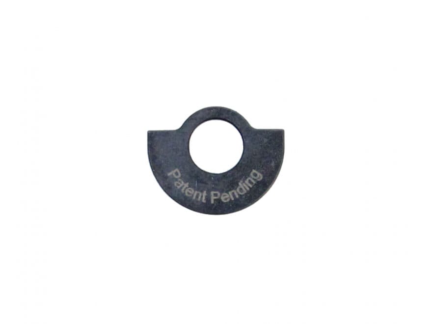

Here is the adaptor. These will get rid of the gap between the slide and frame.
It says it fits the G21/G41 models.

A complete Gen 3 slide works just fine on a Gen 4 frame. In fact the only differences is the recoil spring assembly between the two and the nose of the slide. You don't have to use the Gen 3 to Gen 4 slide adaptor but you will have a gap up front if you don't. That gap will not effect function, it just looks ugly.
