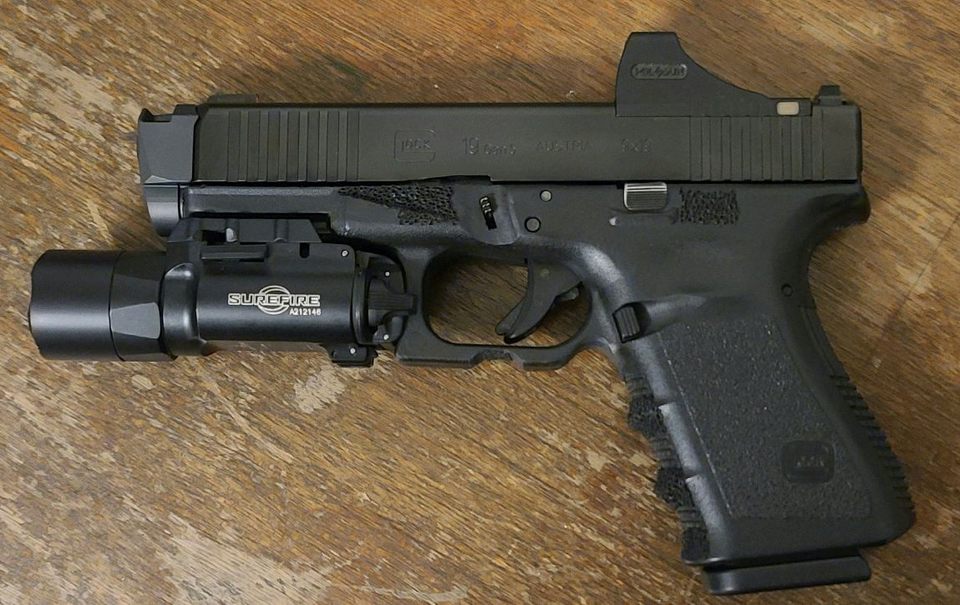

200 more rounds at the range (400 Total so far) with no issues! 100 Magtech Steel Case, 75 reloads 115g Berry's 5.5g titegroup, 25 Rounds CCI/Speer 124g +P JHP!
This is my 2nd G19, bought in 2008
I did all mods myself.
Undercuts, smooth Glock Knuckle areas
Mild stippling
Gas Pedal
Gen 5 MOS Slide
Radian Ramjet/Afterburner
Ameriglo Protector sights
Holosun SCS MOS
Polished internals aka $0.25 trigger job
3.5lb Ghost Connector with overtravel stop
Vickers Mag & Slide Catch
Back cut behind Mag Catch
Tungsten Guide Rod & round spring
Surefire X300U
Image attachment

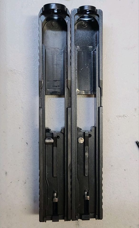

As for what's needed to do the Gen 5 Slide Swap:
1. Bore out the front of the frame to accommodate the larger bottom/front of the Gen 5 slide (because of the size of the dual Recoil Spring Assembly RSA). This is where you'll spend most of your time.
2. Adapter for Gen 3 RSA to use on Gen 5 Slide
3. Change rear slide plate to Gen 3 (not necessary, but looks better IMO
4. Safety check, and enjoy!
This took about an hour and a half.
Here you can see the functional parts are essentially in the same spot. Gen 5 left, Gen 3 Right.

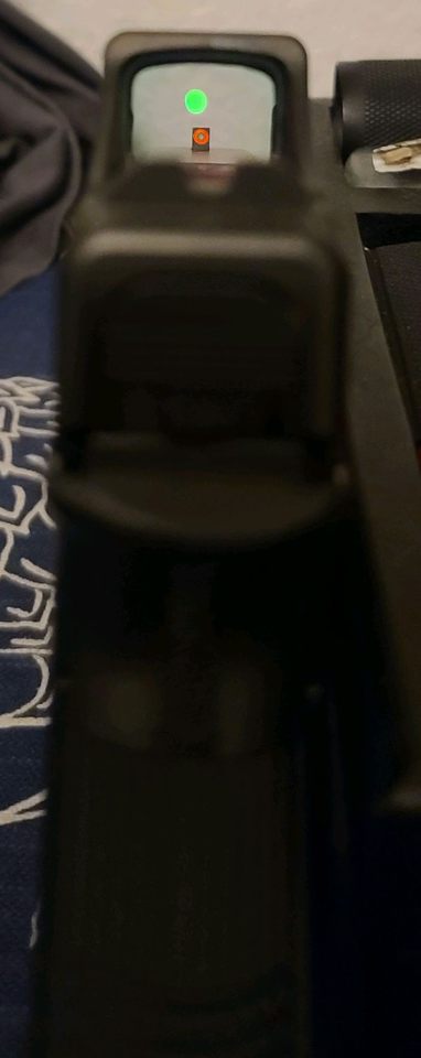

I wanted to use an optic that would cowitness with factory height sights, the SCS MOS does it best from what I've seen. And it doesn't look terrible :)
As you can see, this thing is LOW!
Image attachment
I have Shield RMSc' optics on my G43 & G43X & RMS on one G26 which cowitness' with factory height "iron" sights as well, so I'm already used to finding the dot fast with this height optic/sights and didn't want to change it up.
