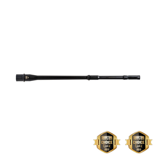

I want to build a light weight AR rifle in 5.56x45 as a range toy - decided a Faxon pencil barrel was a good choice -
But they also have a gunner barrel
Pencil 1.2 pounds - gunner 1.37 pounds same price.
Which would you pick?

People are always buying barrels, never had a problem selling barrels on here. If lightweight is your goal, and it’s just for range shooting, the pencil one is the clear choice. However, if accuracy is a larger factor, and you “may” intend for this rifle to be used for other things that “may” require more shooting, such as shtf or whatever else you are concerned about, I’d go with the heavier gunner barrel. The heavier barrel should have a stiffer contour, mitigating barrel whip, and will run longer under heat. If those are not your concerns, f it save the extra few ounces!

I added up the stuff I need to build the upper. I am almost at $550 / no sites or optic but including the 16" Gunner barrel with built in flash hider (on sale at Primary arms for only $208.16 regular price $236.55, but $259 on Faxon web site)
Faxon Firearms 5.56 Mid-Length Gunner AR-15 Barrel with Integral Flash Hider - 16"
Coupon code save12 gives you 12% off!
