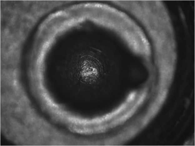

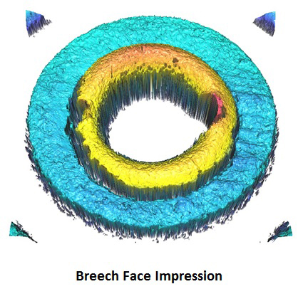

Looks like the data collecting interest is in more than just collecting barrel markings. They call it data "sets" case imprints from the breech face, firing pin prints as well as barrel marks on bullets. Not sure when this data collecting started I would guess somewhere around 2014.
Data Format and Meta Data page. For cartridge cases, our focus is on toolmarks generated by the firearm's breech face and firing pin.
For cartridge cases, the regions of interest include the breech face and firing pin. The respective data sets contain:
  • three-dimensional topography data and two-dimensional reflectance microscopy images (ring light and 6 o'clock side light) of the breech face impression, which may include the firing pin aperture shear, and
  • three-dimensional topography data and two-dimensional reflectance microscopy images (ring light) of the firing pin impression.
3D Topography of Breech face and Firing Pin Impressions
Download
| Image info
Download
| Image info
2D Reflectance Microscopy Images
Breech face impression (ring light)
Download
| Image info
Breech face impression (side light)
Download
| Image info
Firing pin impression (ring light)
Download
| Image info
For bullets, our focus is on tool marks generated by the barrel's rifling lands. The respective data sets contain three-dimensional topography data of the land engraved areas.
