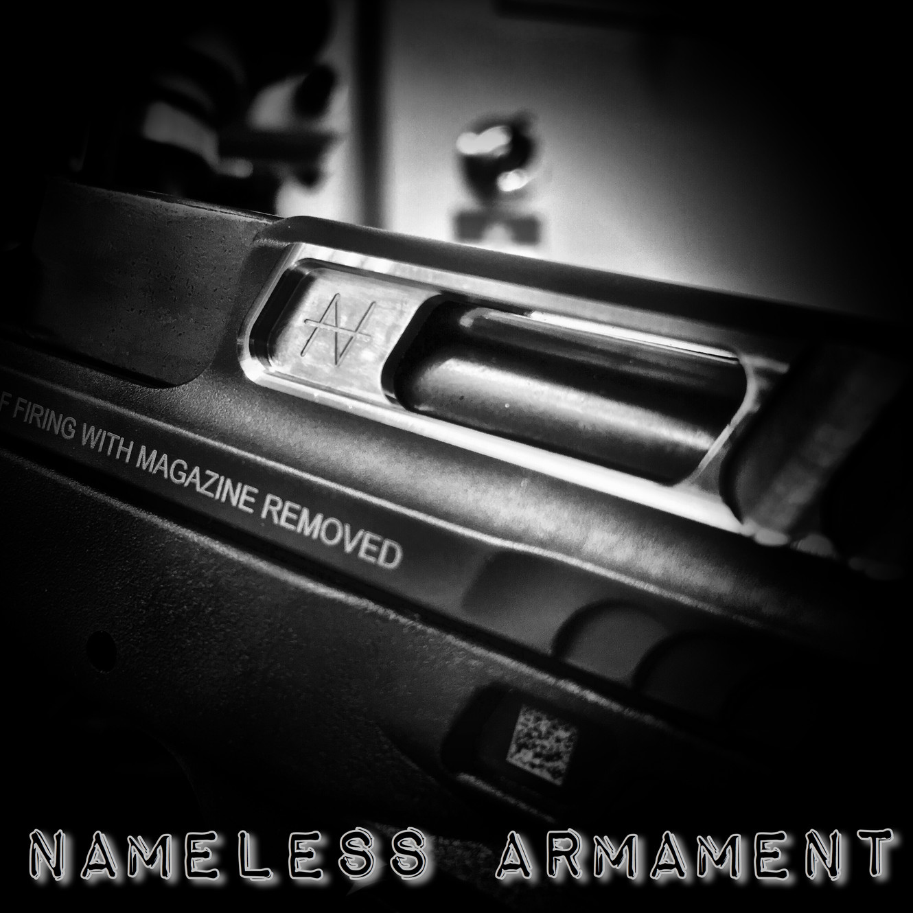

I will second Nameless Arms. Excellent communications and top notch machining.
