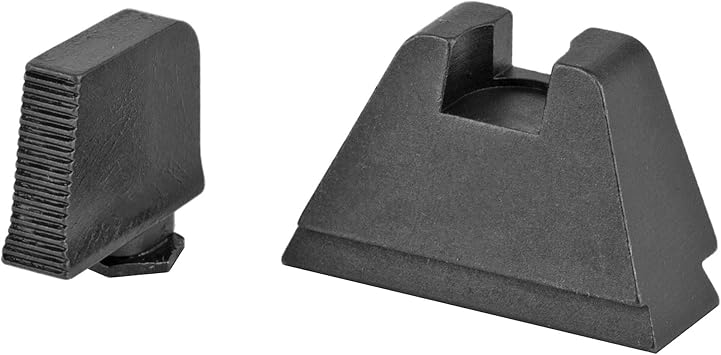

MOS with plate sits a bit high - a usual suppressor height was not enough for leupold dpp on my g34. i used this set for co-witness, it is higher than a usual suppressor set.
if you go here:
that set is labeled as '3XL'. with DPP those sights sit at same exact level as the DPP top plate, so you can use them, but they do not show up in the window, you can only see their tops and it works just fine.
if you want co-witness to be protruding into the lower third of the red dot sight window - you need a set with 5XL - like a GL-682.
also, pay attention to the 'except 42/43'.
