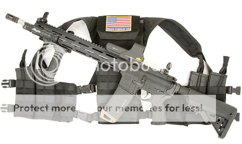

My next upper is going to be the 18" version of that, dead sexy upper.
Configured like so:

That is awesome! That thing should be able to shoot sub MOA all day long. I just question weather I need the added accuracy or durability.
I find that if you even wonder, you'll kick yourself if you don't go for it.
The "I should haves" last a LOT longer than the pain of that extra couple hundred bucks.
