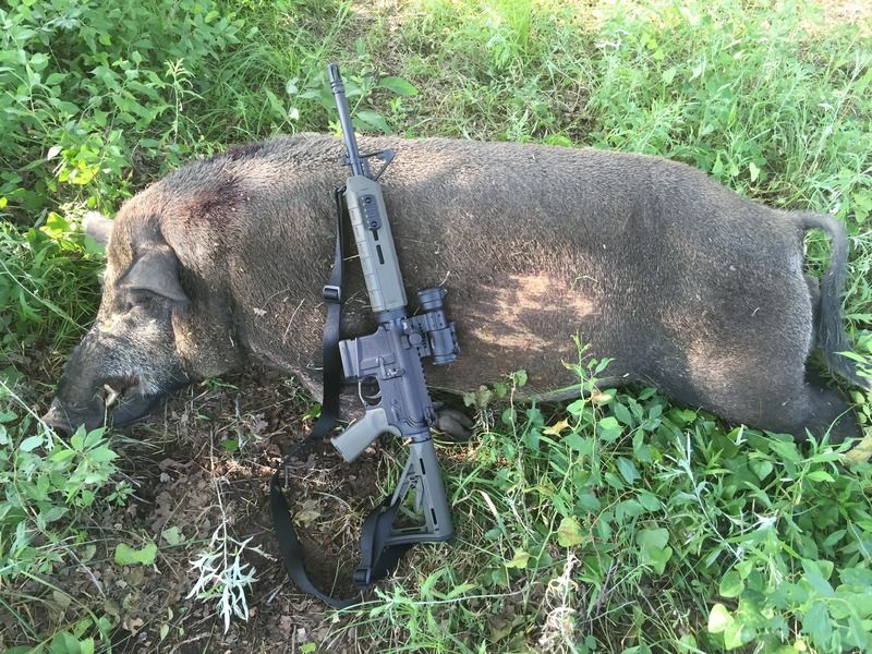

I shot a 325 lb North Texas wild boar this week with the PSA 300 BLK rifle and Barnes 110 gr VOR-TX ammo at 30 yards. The boar stood and squealed, flailed on the ground and then ran 40 yards before collapsing. I hit him in the top of the neck as he faced me. The bullet hit the neckbone. I haven't been able to recover the bullet yet.
I am pleased with the rifle and ammo. The 300 BLK requires good shot placement on such a big boar. Based on the results, I wouldn't hesitate to use the combination on a whitetail or hog at <150 yards. I was hunting at night so I noticed the low flash. The 300 BLK recoil is light and the blast is low. I really like the cartridge and plan to put together a 300 BLK pistol and then SBR soon.
