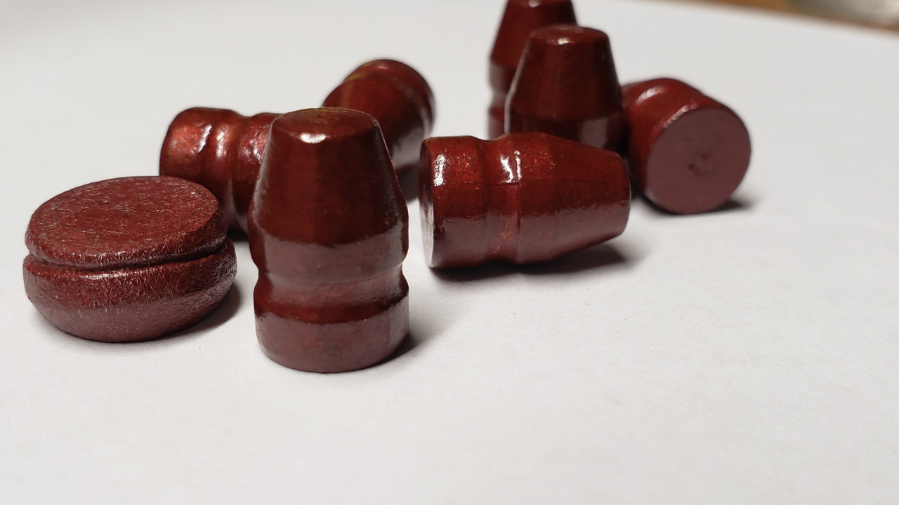

I revisited Hi-Tek Supercoat again. I have been primarily shooting my powder coated cast for the past 4-5 years. I've suspected that Hi-Tek would be a quicker overall process for large batches, even though it requires multiple coats. That's presumably why the commercial guys use Hi-Tek rather than PC.
My first attempts with HT were disastrous, and scrubbing lead isn't fun. Dabbling here and there, I wasn't satisfied.
This time, I think I got it down. Based on feedback directly from the Aussie Hi-Tek guy, and thoroughly reading and re-reading the instructions, I'm happy!
I did a test run of about 200 LBT 401-175-TC bullets. Hi-Tek takes a lot more specific attention to detail than PC, and I am guilty of kind of not being as deliberate on prior attempts.
While focusing on repeatability, here is what I did differently:
1) actually weighed out the powder (20 grams/309 grains)
2) measured the acetone (100 ml)
3) measured the amount of bullets to coat in the tub (equates to 200 180 gr)
4) measured the amount of liquid to add (1 tsp per 200 10mm bullets) to barely add a thin coat
5) swirled bullets in coating for 30 seconds and dumped onto a wire mesh rack before the acetone flashed off
6) gave a couple hours to COMPLETELY dry (it is cold)
7) monitored the oven thermometer to determine when temps recovered to 385F after the door was open, then let it go another 8 minutes
Let cool then repeat.
Transfer and smash tests passed swimingly!
I'm totally happy. My oven can bake at least 500 at a time. Doing batches, I could easily get a few thousand done in a couple of evenings with minimal hands-on work.
Here they are in Brick Red. Any input/criticisms would be appreciated.

Outstanding as always, Taterhead. My question is what are you gaining with the extra cost and work going the HT route over simple PC?
Thank you.
The short answer: scale.
PC is simpler. No question. For smaller batches, PC all the way.
I'm still formulating this, but my mental math indicates that at some volume, HT takes less effort and time. Most likely why the commercial outfits HT and don't PC. Coating 200 takes 30 seconds. In the amount of time that I did 200, I could have done 1000 without an appreciable increase in time. Cannot say that with PC.
As far as cost, I don't know if it is more expensive or not. I haven't done the math. 2 times one tsp of solution coats 200 10mm bullets. Most of the solution is acetone. A little HT goes a LONG way.
These look great. Hi-Tek coatings have decreased the cost of reloading and I have been testing a few.
Do you have a picture of the projectile before?
Do you know the mil thickness you applied?
Thank you.
It looks like about 1 thousandth inch (plus maybe a skosh) after 2 coats.
As-cast from my LBT 401-175-TC:

Update. Success!!
Had some range time with this initial batch. No issues whatsoever. Right away the distinctive odor of Hi-Tek ammo was extremely faint, unlike my less successful earlier attempts.
These loaded and ran great. Zero leading this time.
Next up is to scale up the process to more than 1k. I think Hi-Tel is going to save a lot of time over PC for larger batches.
PC isn't going anywhere for me. I'll still use it for smaller batches and maybe full pressure 10mm ammo. PC seems more trustworthy for high pressures, but that's just a hunch.
