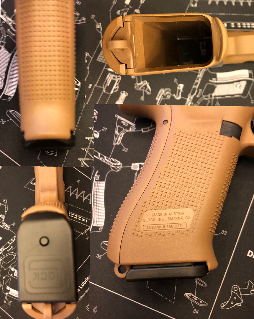

very easy mod if done slowly. Removed just enough material to make it compatible with Gen5 baseplates. After removing the material I used 800-1000 sandpaper to smooth the cut. There are some tool marks but they are insignificant and not visible from the outside. Also wanted structural integrity so I just removed enough for the magazines to reliably fit. It works great and looks good too in my opinion. I wouldn’t be surprised if Glock does this in the future as a frame modification like the beveled frame. Now no worries. All 17 round mags work reguardless of Generation. Mag compatibility has always been a huge selling point for Glock. It just makes sense especially for a pistol marketed to civilians.

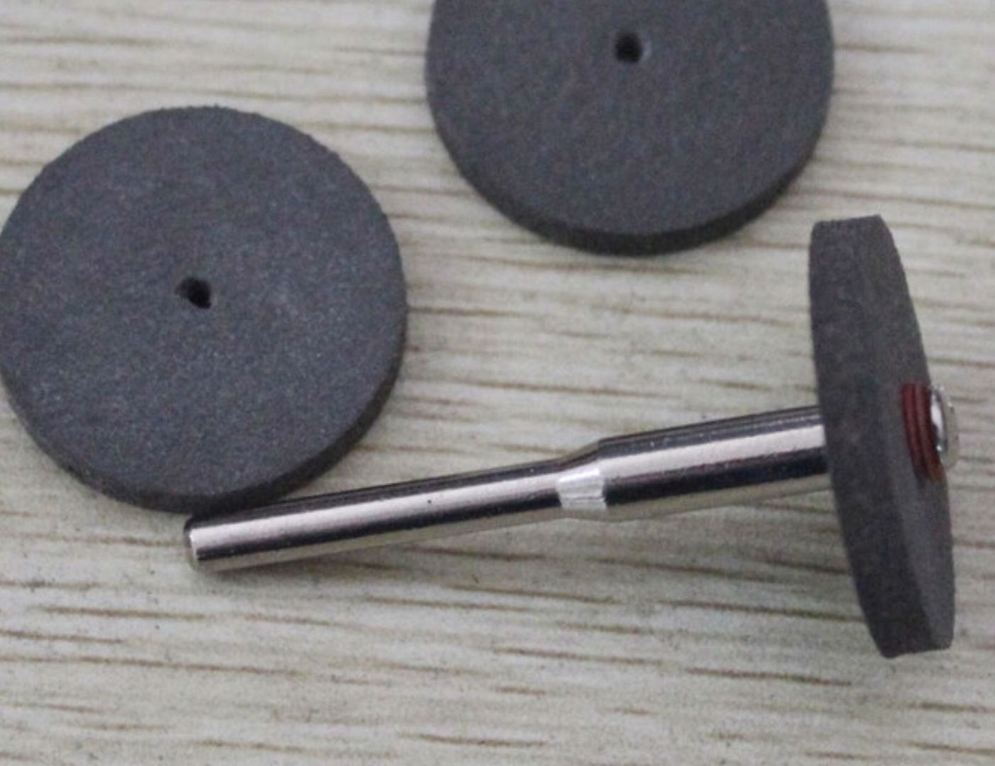

Used a dremel wheel like this. And used a magazine for test fit. Went very carefully and slowly.

You know here is the thing. If you are capable of doing a good mod that’s functional. Go for it. If not and you will mess it up change the baseplates. You have to make that decision for yourself. It’s your hard earned money. I personally see value added in my mod. I think it looks professionally done. Plus you can’t see that it’s different without looking closely into the magazine well. It’s still very structurally strong. In fact that plastic projection is thicker still than the sides of the magazine well. Simpler is defined in the mind of the owner.
