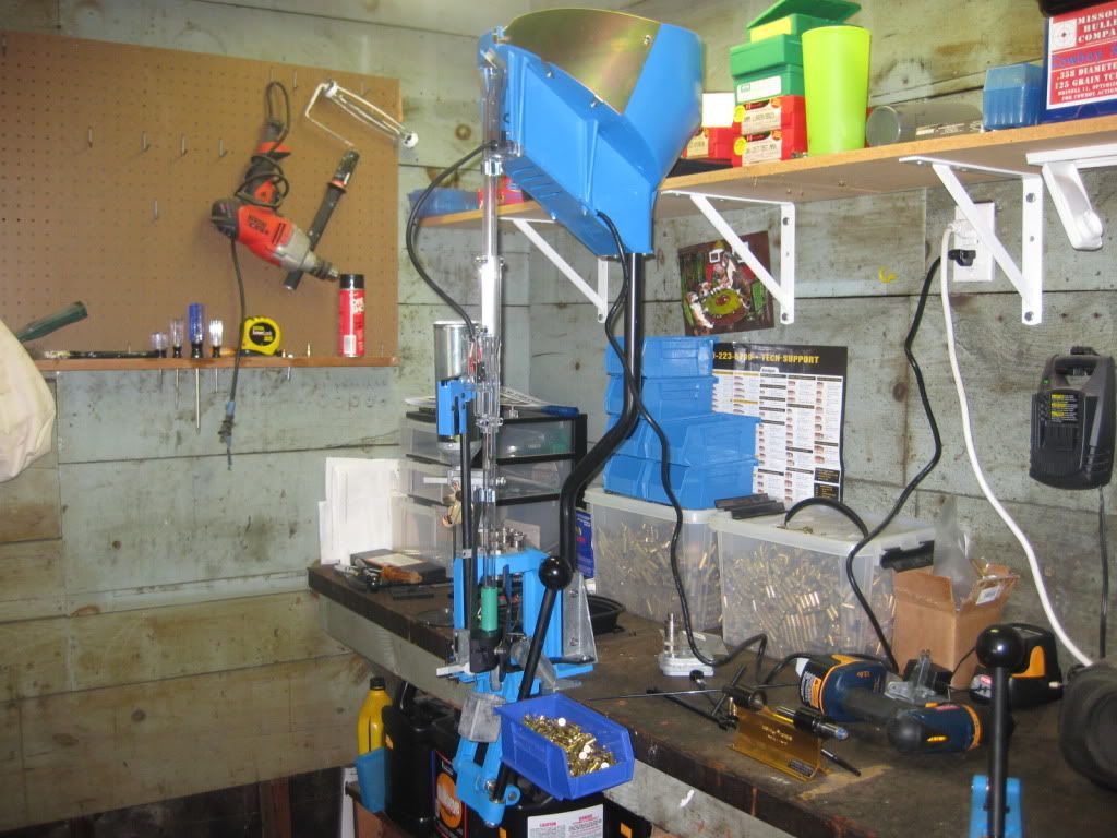

heres a nice pic of one! also it does not do rifle.. but if i had a 550 and didnt want to buy a 650 this would be kinda where its at if your 550 is dedicated your probably better off.
