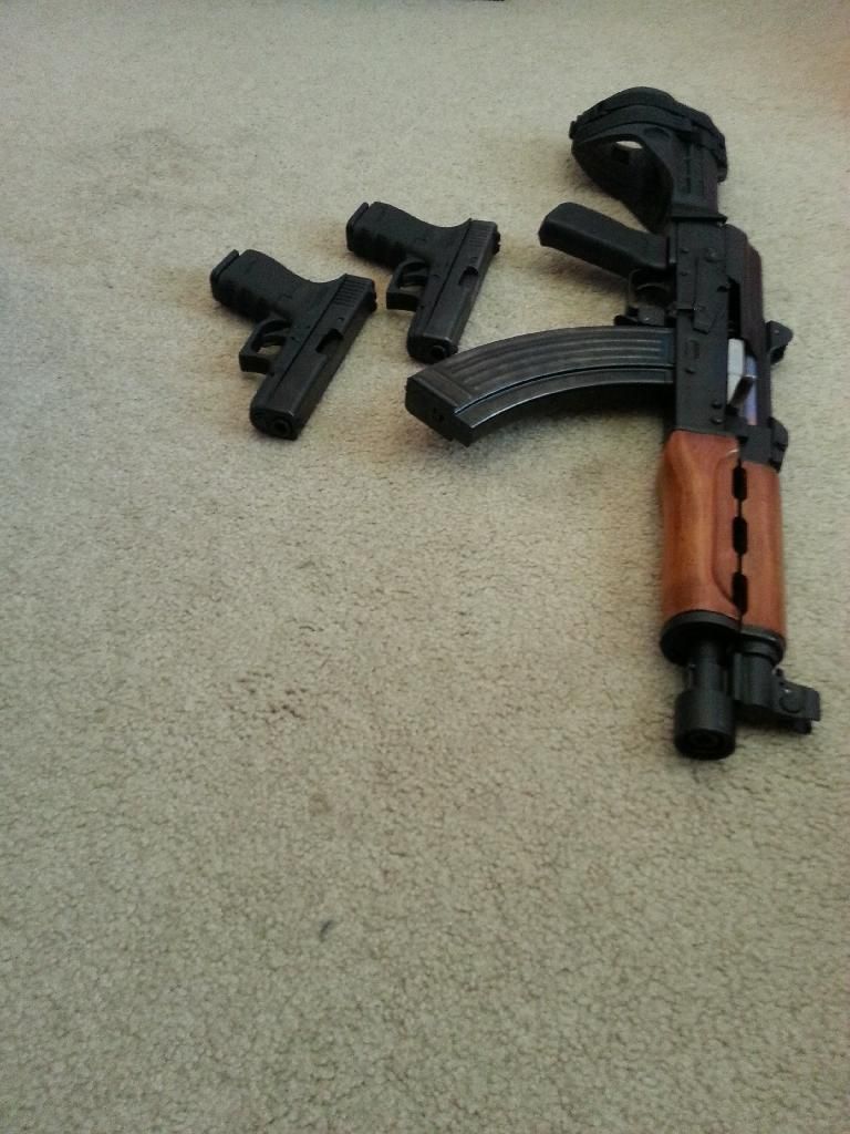

I would like to fix up my ugly Draco wood. I want to find some nice swelled grips. I. Keep spending my firearms funds on ammo. So....
