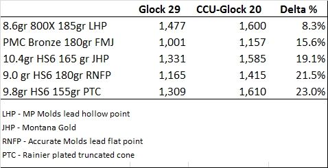

Mine arrived about 45 minutes ago. It is quite nicely-made, I must say--certainly beats the pants off an M3 grease gun by a long sea mile.
The 10 Ring
The 10 Ring
Some electrical tape over the barrel (with the end dangling, of course), a sling and a stock...should be perfectly-equipped to manage the zombie situation, when it inevitably comes.

Are these still the 205gr bullets you're shooting--what's the mold? That's mighty impressive!
That was the 200 gr shallow hp that day if I remember right. Or maybe it was the 205 flat. I forget. The mold is a custom one off or cast bullet forum. Mihec 10mm with 3 pin options. They just had a re run. If I did it again I would order the 190 mold instead of the 200 mold. 190 give u way.more speed in the 10mm.

That's amazing...I just now picked up the 190 gr mihec 4-cavity with the 3 pin sets from the mailbox. Was seriously thinking of firing up the pot but I'm just whipped and would probably hurt myself. Can't wait to get the mold broken in...and can't wait to get the CCU assembled (I forgot to buy a buffer tube and castle nut...duh).
