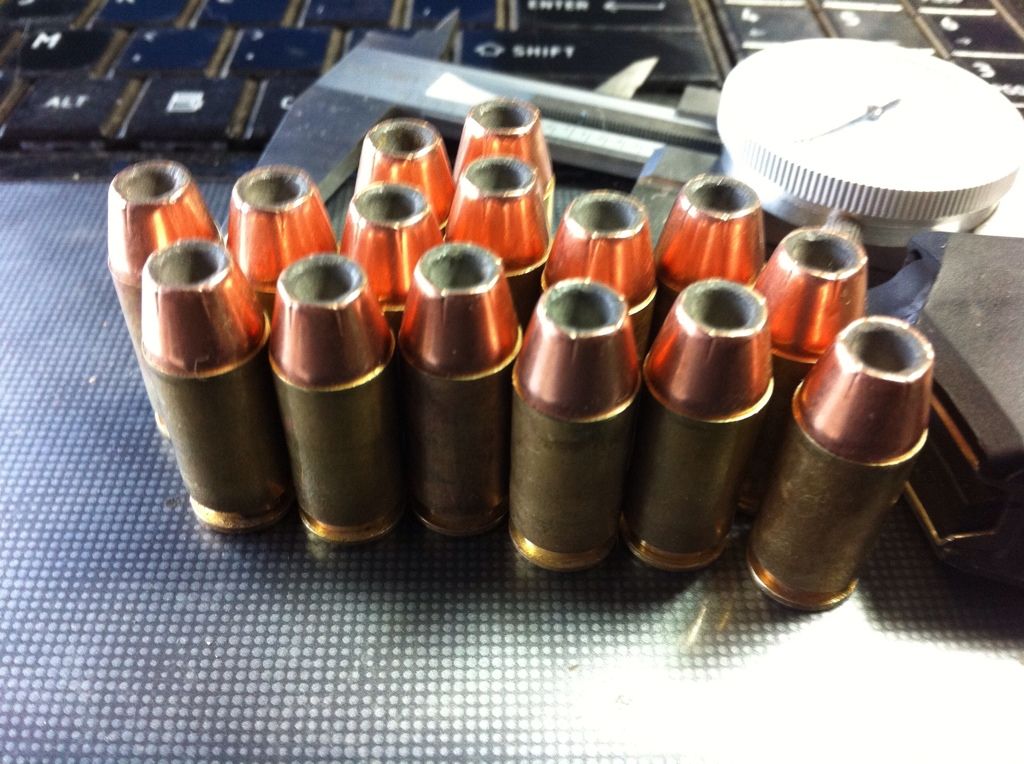

Just fired off the WSF loads
Reloading
Recoil was similar to some factory rounds but this starting load seemed VERY accurate(or the Advil is kickin in,my elbows and wrist are wasted today) as I hit the 100 yard plate 11 out of 15 and I'm severely out of practice with my G23
I'm going to have to work with the WST loads but I'm going to load up a small stash of the WSF 165JHP's I tried today, then I'll have to order some lead in 40 caliber to try out.
I have a fair amount of SPP's and 40/10mm bullets to play with and I'm golden on LPP's and 45 bullets.
