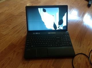

After the daily abuses of college life. My laptop couldn't take it any more and now has a good crack in the LCD screen.
I watched some youtube videos and I think I'm going to try to fix it on my own (I know famous last words) I have some experience building a PC so i'm not totally mechanically illiterate
Does anyone have any website recommendations for replacement laptop screens? and are there any quirks I should be aware of while replacing the screen?

1) Try to get an OEM part from a reputable vendor. I do not have any recommendations for screens, sorry.
2) Take a lot of pictures as you disassemble it, this will help put it back together.
3) Do it in a quiet, neat environment with lots of room to work. Keep track of all the tiny screws & have some small screwdrivers handy.

Good advice to follow from Dr.Jones. I have replaced numerous laptop screens over the years. What make/model laptop is it? That will help in suggesting a good screen vendor. I use different ones for different brands.
Also, the best thing you can do is try to get yourself a hardware maintenance manual for the model laptop you have. Most manufacturers put them out on their sites in pdf format. I have one for all the models in my current environment. They help tremendously when replacing parts like this.

Sony Vaio PCG-71913L
One problem I'm facing is they sell two screens a 15.5 and a 15.6 I might just have to remove it to make sure which is the right one to order

How old is your laptop? If you've used it for 4-5 years for college, it might be a better long-term investment to buy a new one if you have the cash.
With that said, screen replacement is extremely easy. Just Google your PC and screen replacement. You will most likely find the manual or a how to do it by somebody.

can't recall when I bought it . but I want to squeeze the most life out of this thing as I can. the replacement screen is only $60 dollars which is better than a $500 laptop

Ebay is usually the best place for that kind of stuff. Direct from Hong Kong (takes a while) but it bypasses at least one middleman.

As long as you aren't dealing with static sensitive parts you might want to use some non skid shelf mat lining or a tuper ware container when you disassemble the screen so that if the screw or part falls it won't roll off the work area. I use the shelf liner when working on tools and so on.

If I were you, I would do just that and make sure I ordered the right one the first time. Best price I found from a reputable seller looks like Amazon. The seller was Thomas Screens. I have bought screens from them a few times without issue.
Here is an excellent video tutorial on the screen replacement.
I tried searching around for the manual but couldn't find anything useful. It appears Sony is one of the few that does not make the service manual available on their site. I checked out the video though, that should be a fine substitute.

thanks for all of the help so far, turns out I have a 15.6 while tiger direct (the guys I bought it from ) advertised it as a 15.5 ( also explaines why I saw only 15.6 in replacement screens,
ordered the part and i'll update when I replace it

Before:
After:
Thanks again tech talk!
