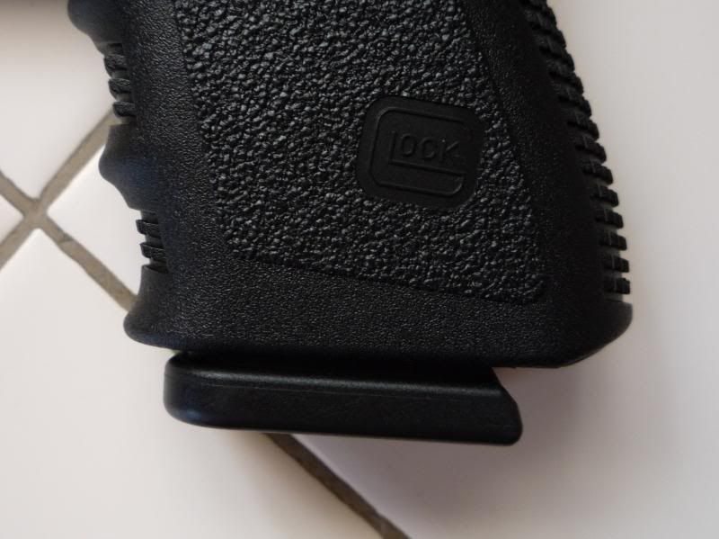

I decided I'd make this thread showing the process I used on my extra G19 to stipple it. In past threads I've only ever given pictures of the finished products.
First thing I do is dremel the magwell cut outs for my super high speed mag rips (please read the sarcasm):
STOCK:
DONE:
Then I do the finger grooves and back strap with an aggressive texture:
Make the outlines on the gun where I want the stippling done:

Start filling in the blank areas:
FINISH:
What do you guys think of my newest G19?

inebriated,
Walmart $8 soldering iron. Fine tip.

Posts: 291
slash method = hold fine tip iron at about 45 deg and tap and drag (kinda like making a real short incision with a scalpel)- spread the slashes out and do about 1/3 of the target area and rotate 120 deg, repeat and then repeat again - this ensures all your little slashes are going in random directions
it actually looks like a rougher version of a Smith M&P

I hear you guys on the crater thing. I go very shallow with quick taps. Although I also think it looks better, I mostly do it because I am afraid going to deep with the stippling will cause some type of frame weakening. I'd consider mine more of a dimple than a crater lol.
11BTaz,
My advice would be just to do it. I practiced on a vitamin container lid then did a polymer mag then just said screw it and did my own Glock. I've now done M&Ps, Glocks, XDms, Rugers, CZ, etc. Get a cheapo soldering iron and take your time. DO NOT let the iron rest on the polymer more than a quick tap or you'll burn deep. If you get good at it then it's an invaluable skill since you can stipple whatever you want and don't have to pay for it .
