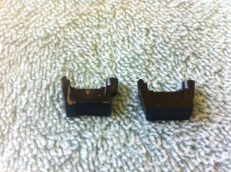

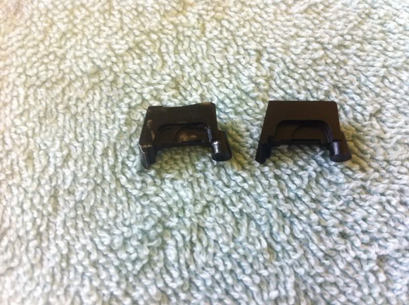

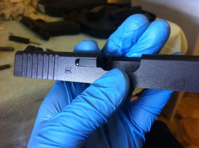

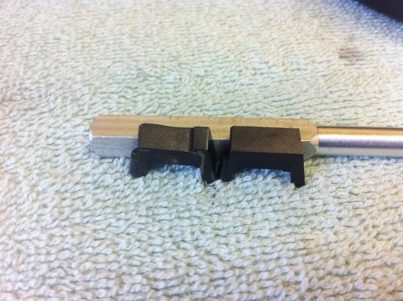

Originally Posted by GPBob View Post
Arc Angel, you said the Lone Wolf extractor had a worse ejection than the OEM. Also that the SLB and plunger spring may also have some bearing. I told of switching extractors between new and newer 19s and whichever 19 had the latest extractor had the problem. So in my situation, a different extractor for my latest 19 might be the answer for me. I'm hoping that the Lone Wolf extractor saves the day.
My two 26s which are early 2011 and 2012 models eject just fine. Do any of the 26s experience poor ejection? If things don't work out for my 19, I'm thinking about trading it for another 26. That is unless it's another crap shoot like the 19.
In and of itself I very much doubt it. Personally I’m with the poster who said that you’ve got to change, at least, two or more components before you can expect a positive result.
Originally Posted by Beretta92guy View Post
I had been saying this MONTHS ago, that the slides were out-of-spec ....
Yeah, I’m starting to think that you’re right, too! The size of the slide cutouts for the new MIM extractors, at least for awhile and on some units, might have been increased; maybe, by no more than 1/1,000th of an inch, or so, but increased nonetheless. (Whether or not Glock, GmbH is still doing this, or whether or not this was done universally, I do not know?)
I’m, now, running the newest Glock OEM extractor; and there is a lot of play in that sucker - Not just up and down, either. There’s, also, a discernable amount of forward and backward movement, too. I’ll tell you something else I’ve noticed: Much of this, ‘extractor problem’ occurs when the expelled casing becomes able to slip downward inside the extractor’s claw. All it has to do is slip by, about, 1/100th of an inch; and, voila, a #336 ejector is going to hit the 7 or 8 o’clock position on that case head with potentially disastrous results!
(Watch your eyes! So far, I’ve taken more than a dozen strikes to the bill of my ball cap, as well as 2 or 3 ejected cases right into the front of my glasses!)
From what I can tell it’s not just the symmetry of the extractor claw or the height of the extractor that’s involved. The problem is more complex than that. For instance: If the diameter of the slide hole the extractor's round, ‘movement limiter’ nests into is slightly oversized, then, there’s going to be just enough additional front-to-back movement to produce a discernible effect on the extractor's ability to tightly hold onto to a moving case head.
Neither do I agree with the fellow who’s doing so much posting about this problem over on M4 Carbine. Why? Because by the time the barrel moves backwards and ever so slightly touches the top of the locking block this problem has already begun to occur. Barrel movement, in and of itself, is NOT a factor in the, ‘BTF problem’.
I’m, also, against lowering the height of the slide's ejection port because this is a remedial solution that addresses a symptom of the problem rather than the problem, itself. SOMETHING has to hold the ejecting cartridge head in place and prevent it from slipping downward as the case is pulled out of the firing chamber. (The question becomes, 'What'?)
It should, also, be obvious that the downward moving barrel applies only a minimal amount of downward force to the ejecting case. (In my opinion NOT sufficient enough, nor of a long enough duration, to cause an ejecting case to drop, appreciably.) This problem revolves around a summation of any and all forces that inhibit an ejecting case's propensity toward downward travel.
One factor that no one seems to have considered, so far, is the profile on the front of the slide pickup rail. To my eye, a very slight forward protrusion at the bottom of the pickup rail’s face would certainly inhibit the case head's tendency to drop during the extraction process.
Other factors which contribute to holding the expelled case head in place, and above the 7 or 8 o’clock trouble point include: a more tightly grasping extractor claw, a different extractor claw geometry, a more rigidly held in place extractor, and a different profile on the ejector’s head. I’m, ‘reaching’ on this one; but, I’m also suspicious of any possible difference in the coefficients-of-friction between milled steel, and MIM (sintered) metal. (In other words: A MIM part might be too slippery to work well as an extractor.)
I couldn’t sleep last night; so, after offering the appropriate prayers for Yom Kippur, (The Day of Atonement) I spent the rest of the night meticulously taking my G-19’s slide apart and carefully studying the mechanical relationships between the various parts. The incipient conclusion I’ve drawn indicates that a list of different things both causes and can correct Glock’s, ‘BTF problem’.
This is, ‘Why’ a Glock owner can, occasionally, change just one part and achieve a satisfactory result. This is, also, ‘Why’ ,oftentimes, changing just one part does not work. For lack of better words: A, ‘stacking of mechanical tolerances’ as well as varying finished slide dimensions ALL contribute to this extremely annoying and potentially dangerous Glock problem.
Neither have the factory’s, by now, several, ‘quick fixes’ actually done anything to genuinely correct the problem. It might, in fact, take a complete slide replacement in order to completely get rid of Glock’s, ‘BTF problem’; and, with any foreign company as historically omnivorous as Glock, GmbH/Inc., I don’t see much chance for something like this to happen. So, workable solutions are going to be up to: you, me, and a few imaginative Glock parts suppliers. Good luck to all of us!
If I have anything new to report after examining a flawlessly performing Glock later on today I’ll post again on this topic.
