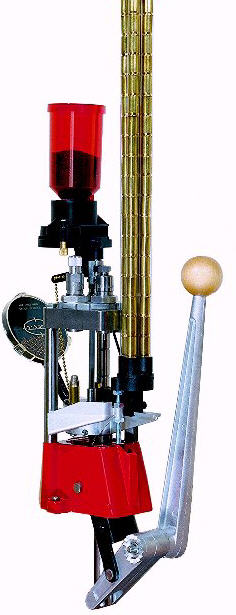

Eric Cartman

Originally Posted by WiskyT View Post
Nice picture of a small boat anchor.
Not even that, too light for a good boat anchor.
that's just wrong

Originally Posted by marvin View Post
that's just wrong
There's a thread about a 550 priming problem I haven't read yet. I'm going to head over there and see if I can cut and paste this into that one too.

The difference is Dillon priming problems are fixable by a meir mortal.
