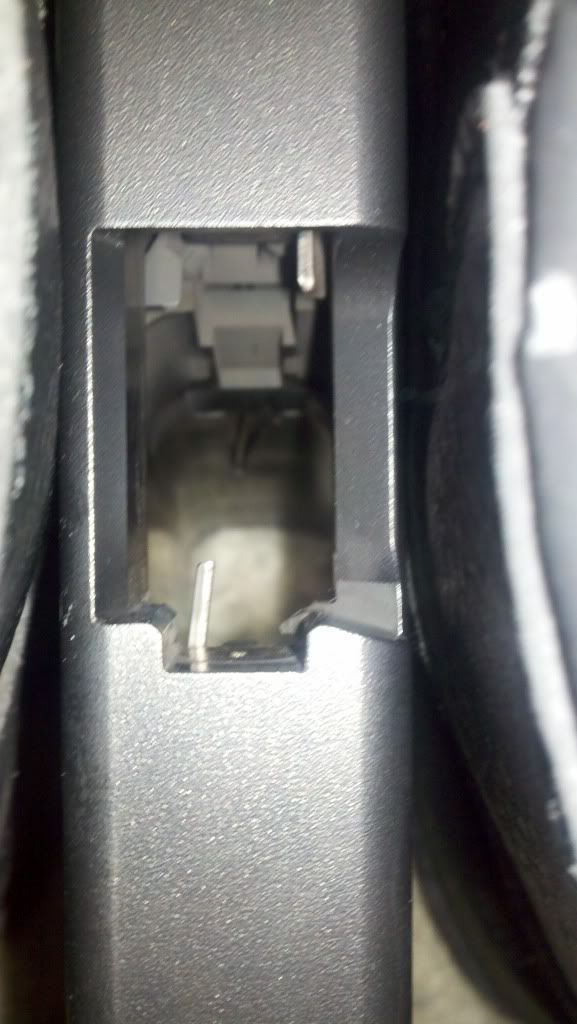

I get brass to the face I have the 336 ejector. Could someone let me know if my G19 has the dip or non-dipped extractor I have pics below.
The last 2 pics are the same I just rotated for a different angle.
If you need more pics let me know. Thanks fellas.
frostyicy is offline   Reply With Quote
Old 07-24-2012, 07:06   #14
SJ 40
SJ 40's Avatar
Join Date: Jan 2011
Location: Vermont
Posts: 3,829
Your Extractor or the portion needed to identify it is located on the right hand side of the slide,directly behind the ejection port. It's not seen from the correct angle in those photographs.
Look along the top edge of it between the top edge from the right hand side of the slide,on many guns it can be seen without having to detail strip the slide. SJ 40
