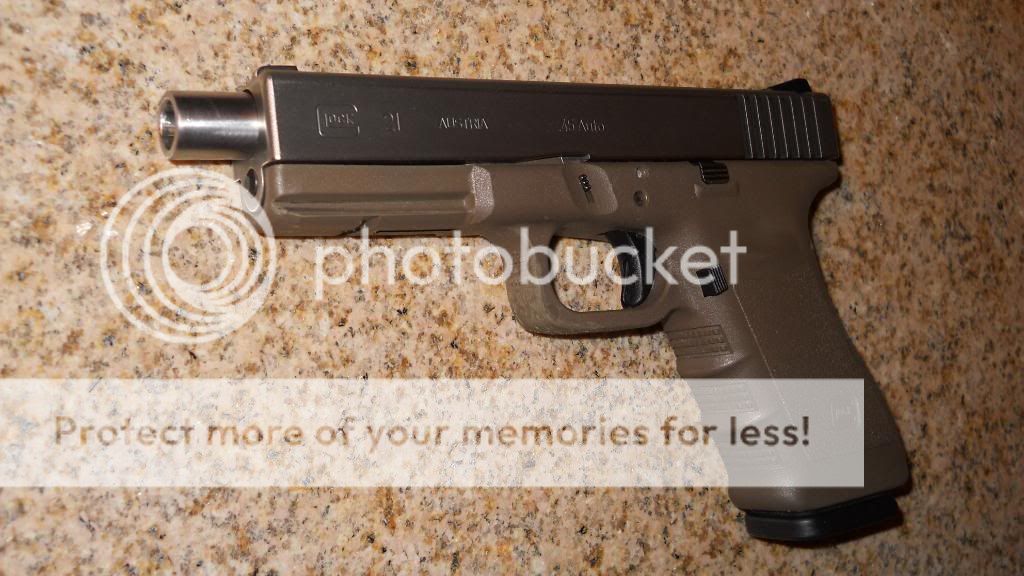

This is the beginning of my new-to-me Zombie Gun! I plan on starting off with 45 Super and then we will see what happens. At the moment, the only thing mod about her is the 6.61" LWD-21L45TH, a 22# Wolff recoil spring/guide rod and Wilson Combat recoil buffer. She came with Trijicon novac rear and standard front night sights. Now that I'm 49 and can't focus on the sights anymore, I think I'll be looking for some laser action. Isn't that just life! I trade for a G21, luck up and get an OD with decent sights and I can't see the bamn things anymore!

Got an LWD compensator ordered, from glockparts.com LWD was out of stock. This was one of the few(very few) times that in-my-face advertising was a help. I found glockparts.com at the bottom of these posts.

Yes your LW barrel has lots better support. I have a KKM barrel and 500pcs of Starline 45 Super brass, but haven't worked anything up yet.

Thanks! I think I might actually keep this one! Ordered me a 24# spring just in case the 22# don't get it done.

I just got back from the local shooting spot and I can say that things were not as I expected. I shot Buffalo Bore 45 Super 185gr JHP through the 6.61" and comp. I had to use my shooting discipline to get shots on target because it was quite snappy. As I do not have a chrony I have to assume that the velocities were what they were supposed to be. I shot about 14 rounds through the barrel/comp without any failures, then I removed the comp to guage the difference and started having failures. In dealing with the FTF's I could not focus on the difference between having or not having the comp. However, when I re-installed the comp, the failures stopped. And then I switched to the Glock barrel and shot some more, without failures, and I was very relieved to see that case bulging was minimal, so now I feel relatively safe having my G21 loaded with 45 Super. Will post pics later.

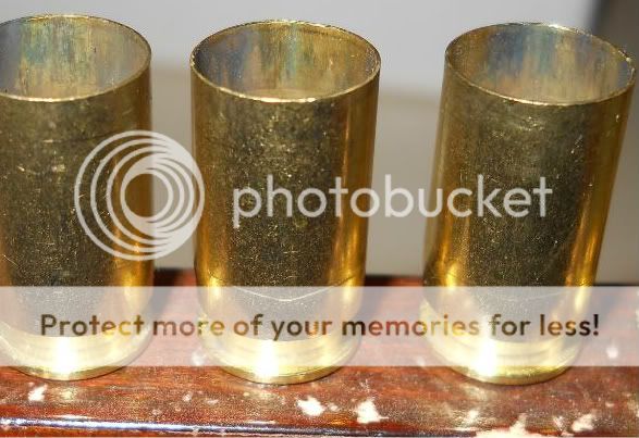

I would have to say the cartridges were taking a nose dive and failed to get pushed into the chamber. But then, it also seemed like the slide was just not getting pushed back far enough. I have a 22# Wolff recoil spring. There may be something to changing out the magazine spring for a stronger one like some folks have recommended.
Although, there was very minor bulging on the web area of the case and there is a strange indentation, which at first I thought was a crack, but it does not show on the inside of the case.

That is interesting. Is it more a scratch or cut than a dent. It is in the same place. Check the chamber for a ridge. Other than that I would have to say it is done during ejection. Don't know.

I think that it is being caused by the propellant pushing the brass into itself, like when a buildings supports fail because of overloading. I am pretty sure it only happened when I had the factory barrel in. Not very many are like that and I only shot about one mag through the factory barrel. I believe that I am going to buy the Jarvis barrel. I read a really technical sounding report, way over my head, that stated the 4140 chrome moly steel used by Jarvis is a superior steel in every way for a gun barrel. I found the report when I was googeling gun barrel steel. Actually it was 416 stainless vs 4140.
Mark a case with permanent marker. See if this is on the bottom or top or.....?

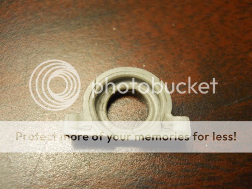

I forgot to mention that the Wilson Combat recoil buffer after only around 100 rounds has started to split in two places. They said it would be good for about 1000 rounds.
The ridge is higher on the bottom side of the case. It kinda seems like the upper portion of the case is being pushed into the lower portion of the case where there is no chamber support.
Do you have a way of checking the length of the unfired brass?
If it is too long, it shouldn't fit the chamber and shouldn't fire, but....?
I would also suggest measuring the unfired brass in comparison to fired brass.
I would also suggest shooting a standard 45ACP load to compare how the this particular brass expands with increased pressure.
BTW, I don't know what is going on, I am hoping that by measuring the brass, I will get an idea.

Unfortunately I do not have an outside micrometer. But I can say that it is new Starline 45 Super brass loaded by Buffalo Bore. I just ran another magazine through the Lone Wolf barrel and no problems, all smooth. So I am going to have to assume that the lack of support from the Glock factory barrel is causing the case to crumple just enough to leave a funny line.
Reloading
And there is an ever so slight bulge just under each line or "indentation", but not above the line.
I guess that we can call the unsupported area of the case the "subduction zone".
