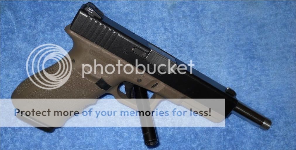

Buffalo Bore 45S 185gn GDHP @ 1300fps I'm assuming from a 4.5" barrel, the website doesn't say.
I will be shooting it from this:
LWD 45LTH, Wolff 22#, Wilson recoil buffer and, hopefully, LWD 45comp.
