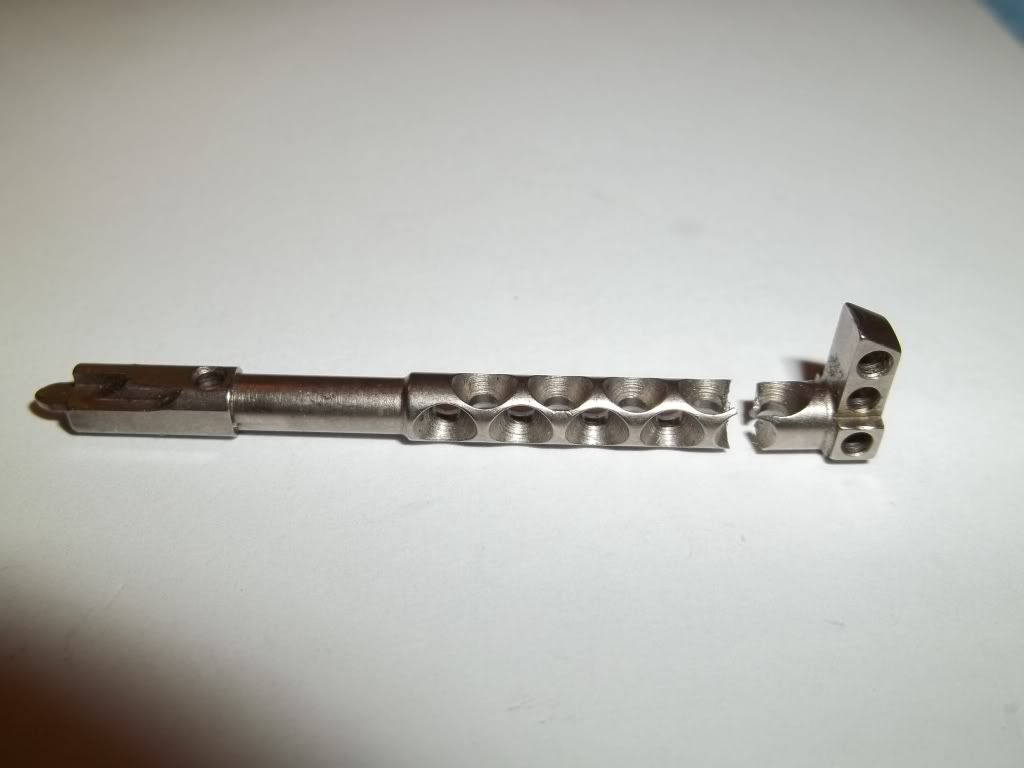

I've got a 2.1# trigger pull with a .25 job,Glockworx V3 race connector,and a Glockmeister spring kit.
I tried a Lone Wolf light weight striker.It was awesome,brought the pull down to 1.8# but it felt better than that.It still had a loud clicking,discernable reset too.I put 200 rounds through it,brought it home and dry fired it a couple times(still in disbelief) and this happened....http://Gunsmithing
Lone Wolf did me right though.
