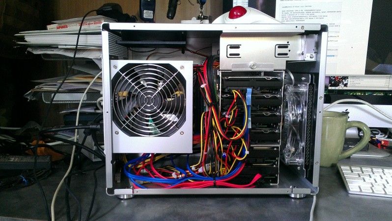

Hi all. I'm currently building a small home server, Ubuntu server 11.10, for music, movies, storage, and security cams. It's an i5 processor on a Jetway JNF9A mobo with 1 WD 500GB OS drive and 4 Seagate 2TB drives set up 3 RAID 5 1 spare.
My other machines are all Mac's so I mostly followed the instructions in THIS THREAD. The first two times I tried to back up my iMac to the server with TM it completely crashed it so I reinstalled from scratch. The second time it crashed the RAID, but (I think) it was only SDB that it had listed as failed. I was able to unmount and recover the RAID with mdadm. The third time I left it to back up over night and woke to find two disks (I think sdb and sdc, but not sure) listed as failed. After much tooth gnashing I found the "failed" disks listed as part of md127 and was able to reconstruct the RAID from scratch.
This last time I went to bed and disabled sleep on my iMac. TM successfully backed up over night. Now I just came home from the beach to find the raid rebuilding from a failed sdc and a fresh, successful, TM backup as of 30 minutes ago.
So, I'm trying to figure out why it's "failing" the disks erroneously and how to fix it. Any help is greatly appreciated.

Possible cable issue?

Cool, I just read your OMV page. Nice writeup. I'm going to snag one of my old boxes from the closet and stuff it full of all the random drives I have lying around and see what happens. I'm giggling already. Maybe make a case for it out of broken surfboards. OK, maybe not, but I think it'll be super fun to kludge the whole thing together.
Good call on clonezilla. I have the other WD 500 in the last bay, but it's not plugged in yet. I plan to mirror the OS drive to it eventually. Depends on whether or not I need the SATA port for another RAID drive first.
Putting it in the safe won't be a problem. 2500lbs of steel and guns makes a hell of a heat sink. And this thing runs super cool anyway. The Lian Li PC-Q08 is a fantastic case if you can live with a mini ITX mobo.
Build specs for anyone that's interested:
Lian Li PC-Q08A
Jetway JNF9A
PSU Coolermaster 460w
Intel core i5 2400 3.1G
8GB Corsair 1333
4 2tb Seagate drives (RAID)
2 500gb WD drives (OS) only 1 currently in use.

OK, so you piqued my curiosity with this post. Am I correct in understanding you're using OMV now?
Anyway, the curiosity part, was this subsonic application. Never heard of it. I just reinstalled OMV and installed subsonic. Interesting app. Not really something I need (mainly because forked-daapd and minidlna work fine for me), but not bad. It installs very easily from the .deb on the site you can download.

That's an interesting case by the way... I almost bought that one when I built my new NAS last month, it was just more than I wanted to spend on a NAS case. It's not quite the speed/specs of yours, but I'm more than happy with it.
Case -- Antec Sonata Proto
Motherboard -- MSI 760GM
CPU -- 2.8gighz AMD Sempron CPU
RAM -- Crucial 8gigs of 1333 DDR3
Power Supply -- 500w Antec True Power
Only thing I kinda regret, is the case. I wish I had went with something smaller. I just got the call that my youngest sister's PC likely bit the dust(I built it almost 9yrs ago). I make put her new PC in the Sonata, and buy me a new NAS case... still debating that though. I don't really need a case with 8-9 drive bays.
If for some reason I needed more 3.5in bays (unlikely, as I still have 2 internal, and 2 external available).. I'll get something like this and convert the 2 of the 5.25in bays to 3x3.5

No, I'm running Ubuntu 11.10 Server. I'm going to dig out an old machine from the closet and fire up OMV on it.
There was a reason the guy that wrote the How-To I followed (mostly) got rid of daapd.
He writes:
iTunes sucks hard (and this is coming from a total Mac-head). That said, if you must use it you can serve music to iTunes devices by installing a daap server called forked-daapd. On the plus side, it will act as though it were another iTunes machine on your network, sharing all of its music, including serving up DRM protected tracks that you may have purchased from the iTunes store when you were younger and much dumber (too dumb to realize that buying DRM encumbered music is completely nuts). On the minus side, it will act as though it were another iTunes machine on your network, sharing all of its music. This means you cannot use cover flow. You cannot make playlists. You cannot see your music in any format other than a giant list of every track on the server. You cannot rate the music.
So feel free to install forked-daapd if you want to use iTunes (I used it for a while back when I had FreeNAS installed, and I still have it installed on this Ubuntu server) but I am not going to bother walking you through it. It is fairly self explanatory and I am not interested in using it myself. That said, I do not wish to disparage forked-daapd itself. It is an excellent package that does exactly what it is supposed to do. It is just iTunes that sucks eggs.
Instead, I am going to suggest you install Subsonic (http://subsonic.org/pages/index.jsp) which is a Java based music server that will allow you to stream music to any machine in the house and to any device out on the internet. The pluses are that you have much better control over your music from wherever you may be listening to it. It is web-based so that you really only need a browser to connect (though we will not actually be using it that way). It is much more flexible and much easier to use than iTunes. The minuses are that you have to install Java on your server, you have to have a web server operating (though it is built into Subsonic and isn't a separate web server like Apache) which has unknown ramifications for security and, finally, the client side web view of your music is so ugly it will want to make you scratch your eyes out. We are talking Android ugly here (and I am a HUGE Android fan by the way, but both it and Subsonic got hit with the ugly stick… hard).
I didn't look into anything different. If I want to switch it up later I'll do that. Just want to get everything tweaked and running right before making major changes.
The size of the case was one of the primary considerations as it was built to live in the safe. This one is nice and short. Very space efficient while still being SUPER easy to work in. Both side plates come off with 6 screws. Super stiff and sturdy, huge front fan for the drives, and it looks sweet. It was a bit more than others, but I think it was entirely worth it. I'll probably use one again for a hackintosh build. It's so pretty it seems a shame to stuff it in a closet.

Crap. I colud have had hot swap in the same size. http://www.newegg.com/Product/Produc...82E16811112339
Now I have to get that case, swap everything over, and build mu hackintosh in this case.
That was another NAS case I considered, but when I did some Googling, there's a pic of what that is "full" and the drive cage had to be bent in so that the power supply could slide all the way in. Very tight fit.
Maybe it's best to go huge/server type case for your home NAS...lol. All these "small" cases, always seem to have at least one or two drawbacks.
http://www.frozencpu.com/products/15...W_SFX_PSU.html --- This one got rave reviews from some folks I know, but I don't like the SFX power supply form factor. Not to mention, $$$
