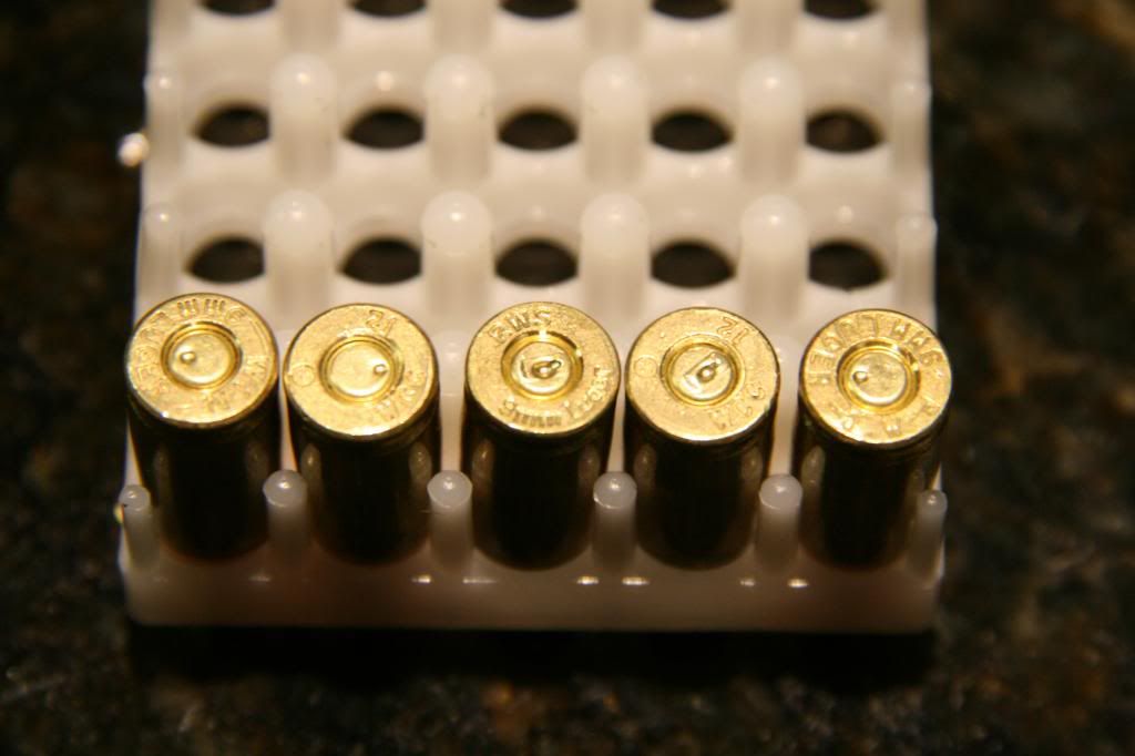

Here's a picture of what I'm talking about with the spring cups, this is on Advantage Arms Strikers.
I had the cups misaligned on my G17 cause me problems a few weeks ago and had a heck of a time figuring it out. Apparently it was causing intermittent light strikes.
