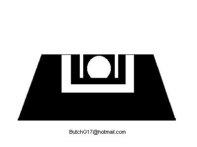

Your sight alignment should look rather like this:
Using a six o’clock hold, your sight picture should look rather like this:
I say ‘rather like this’ above because you are trying to look at three different items at three different distances, the front sight, the rear sight, and the target, but your eyes can not focus on all three at the same time, only one of the three can actually be in focus, the other two will be a little blurry. The one you want to focus on is the front sight.
